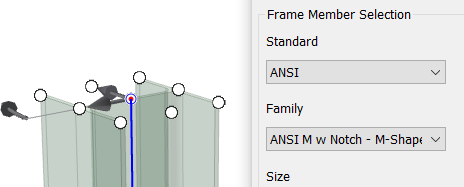

Notch
Trim and extend frame members at their ends to provide a notched fit using one of the following options:
For more information, click the How to Create Custom Profile in the panel or see Author Frame Generator Notch End Treatments

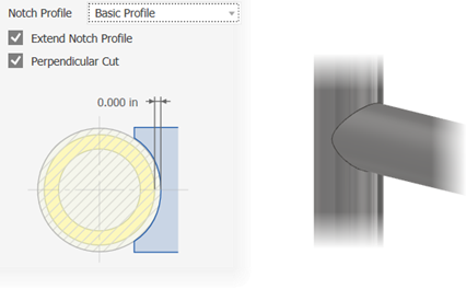

  1. On the ribbon, click Design tab Frame panel Notch.
  2. Optionally, select a saved Preset to configure the notch.
  3. To replace an existing end treatment with the notch, click the Advanced Settings Menu and select Delete existing end treatments. Clear the selection if it is not necessary to delete an existing end treatment.
  4. Click to select the frame members to receive the notch.
  5. Click to select the frame members that represent the shape of the notch.
  6. Choose one of the following:
    • Basic Profile to set a single offset value for the notch.
    • Custom I, Custom C, or Custom T template to set multiple offset values.
    • Custom Profile, if available, to use the custom notch profile in the Content Center family.
  7. Optionally:
    • Check Extend Notch Profile, if available, to extend the profile to an intersection.
    • Check Perpendicular Cut, if available, to create precise intersections such as a laser cut notch for a pipe.
  8. Click Apply to notch the selected frame members.
  9. Continue to notch frame members as needed. When you finish, click OK.
