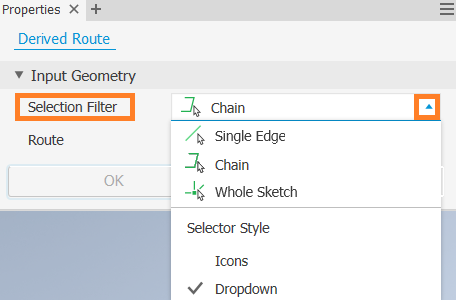

-  The Derived Route property panel displays. Select a 3D line or an arc from which to create the derived route. Select the needed sketch elements from the base sketch, using any of the following:
	 - To select single sketch elements, click the Single Edge button in the Selection Filter, or click the Selection Filter drop-down arrow and select Single Edge.
- To select the longest continuous sketch elements between two closest branch work points including any combination of lines and arcs, click the Chain button in the Selection Filter, or click the Selection Filter drop-down arrow and select Chain.
- To select the whole 3D sketch regardless of branch work points, click the Whole Sketch button in the Selection Filter, or click the Selection Filter drop-down arrow and select Whole Sketch.
