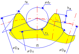

Toothed sprocket properties
Sprocket dimensional properties are based on a specific chain size as well as national standard recommendations. Not all properties are described here because of complexity. For more details on exact sprocket dimensions see the corresponding chain standards.
Two types of tooth form are considered:
The theoretical tooth form is designed so that the chain rollers ride out towards the tips of the sprocket teeth as the chain wears and elongates. There are many ways how to produce sprocket teeth, and the actual tooth form may not exactly match the theoretical form.
Simplified ISO tooth form is determined by the minimum and maximum tooth gap forms. The actual tooth form, which is provided by cutting or an equivalent method, shall have tooth flanks of a form lying between maximum and minimum flank radii and blending smoothly with the roller seating curve subtending the respective angles. By default the Roller Chain Generator uses minimum tooth gap form recommendations.
D f = D p - 2 r i
b s = p t (k - 1) + b f
b a = b ax p
where:
D P
pitch diameter
D a
tip diameter
D f
root diameter
d r
maximum bush or roller diameter
z
number of sprocket teeth
p
chordal pitch equals to chain pitch
p t
strand transverse pitch
k
number of strands
SC
seating clearance
r i
roller seating radius
r e
tooth flank radius
   α
roller-seating angle
h a
height of tooth above pitch polygon
b f
tooth width
b a
tooth side relief
b ax f
tooth side relief factor
r x
tooth side radius
r a
shroud fillet radius
b s
minimum shroud width
D s
maximum shroud diameter
h max
maximum plate depth h max = max(h 2 ; h 3 )
