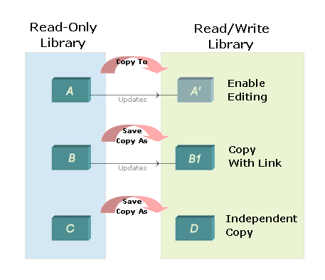

To edit a part (feature) family that is contained in a read-only library, copy the family to a read/write library. Two commands are available in Content Center Editor to copy content to a read/write library:
Copy To copies the family data. It does not create a physical copy of the parent family in the read/write library. The parent family is marked as editable in Merged View and in the view of the read/write library where it is copied. The copied data package receives updates when the parent is changed. All user edits made in the family table and family properties are preserved in the read/write library and can be migrated in new versions of Inventor.
Save Copy As with or without a link to the parent family creates a physical copy of the parent family in a user library. In Merged View, the copied family is displayed separately from the parent family. Only the copied family is displayed in the view of the read/write library. You can edit the table and properties of the copied family. A link between parent and copied families enables you to synchronize copied families with their parents.The following scheme displays the overview of copying families into read/write libraries:
The link has no use until the parent family is edited, and you synchronize the library including the copied family by using the Update Tool. If the link between parent and copied family is active, Update Tool propagates changes from the parent family to the copied (child) family. In case the same data are edited in the parent and in the copied family, all your edits are preserved in the read/write library.
A family with a link behaves the same as independent family with the following exceptions:
Copy To families always create a link to their parents. Save Copy As families can be created with or without a link.
Suppress a link to defer synchronization of a copied family. A copied family with a suppressed link is skipped during synchronization in the Update Tool. Use the Unsuppress command to activate a suppressed link. The library with the corresponding copied family is then marked as Synchronization Needed, and you can synchronize the family.
Use the Break Link command to remove a link to parent for a Save Copy As family. The family becomes independent. You cannot restore a broken link.
