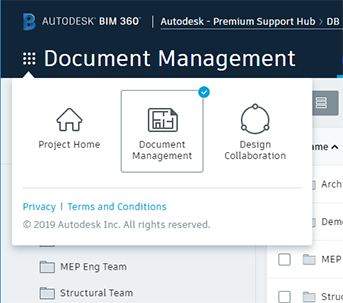

BIM 360 Document Management is where files are stored.
  1. Contact your Revit model supplier or CAD Manager to get access to BIM 360 projects and published packages.
  2. Access the Document Management module for the project.
  3. In BIM 360 Document Management, you check for shared files. Published packages, with or without links, can be referenced or imported in Inventor.

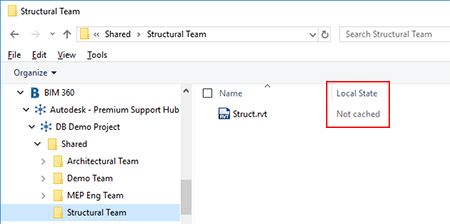

  4. You check for shared files via Windows Explorer. BIM360 drive shows up as a folder, look there for the shared files. The files are listed with a Not cached Local State. They reside in the cloud.
    Note: When opening a BIM 360 Revit file in Inventor, the file is cached as part of the Open process.
