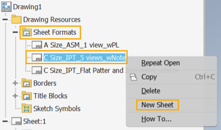

  1. In the browser, expand Drawing Resources Sheet Formats. Right-click on a sheet format, and select New Sheet.
  2. In the Select Component for View on Sheet dialog box, select a model file to place views of the model in the sheet and click OK.

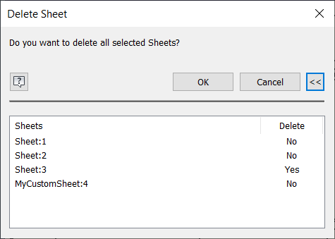

  1. In the browser, select one or more sheets to delete.
  2. Do one of the following:
    • Right-click, and select Delete from the menu
    • Use the Delete key.
  3. (Optional) To change which sheets are selected for deletion, in the Delete Sheets dialog, click More , and then click Delete to specify which sheets to delete.
  4. Click OK to delete specified sheets.
