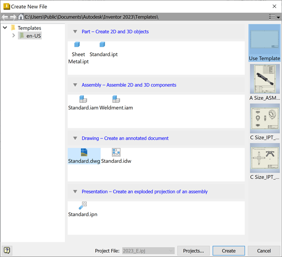

Create a Drawing - New Command
  1. Click New .
  2. In the Create New File dialog box, select a file type, and then select a template.
  3. You can use a sheet format within the template while creating a new drawing file.

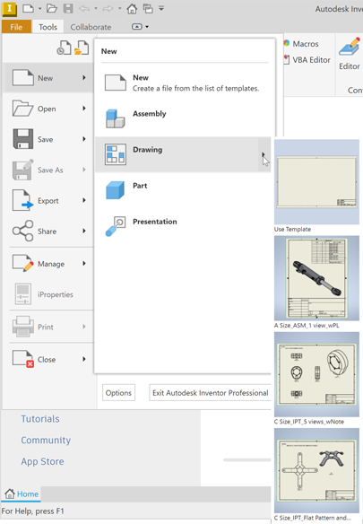

Create a Drawing - File Command
  1. Click File.
  2. Hover over New to display the New flyout.
  3. In the New flyout, hover over Drawing to display the template and sheet format options.
  4. Select a template.
Note: The thumbnails are also displayed for Drawings from the Quick Access Toolbar.
