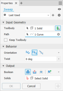

You can use solid sweep to create complex shapes, simulate toolpaths, or to design timing screws. The toolbody is not required to be a revolved or cylindrical body.
Following are some tips for a successful solid sweep:
Before you start the command:
Click 3D Model tab
Create panel
Sweep
If required, enable the Solid Sweep option
in the property panel.
Select the solid Toolbody.
Select a Curve or an Edge to define the Path.
Choose an Orientation:
If using the Aligned option, select the axial direction Vector.
If required, specify the Twist angle. The Twist angle is related to the toolbody, not 3D space.
If required, select the Twist Axis.
The following image shows the effect of a 90 degree Twist angle in an Aligned sweep. The twist angle applied to the toolbody creates a design that can rotate a bottle from horizontal to vertical along the path.
(Model credit: Scott Moyse)
Specify an Output operation:
Join. Adds the volume created by the swept feature to another feature or body. Not available in the assembly environment.
Cut. Removes the volume created by the swept feature from another feature or body.
Intersect. Creates a feature from the shared volume of the swept feature and another feature. Deletes material that is not included in the shared volume. Not available in the assembly environment.
New Solid. Creates a solid body. Each solid body is an independent collection of features separate from other bodies. A body can share features with other bodies. If desired, rename the body.Click Ok.

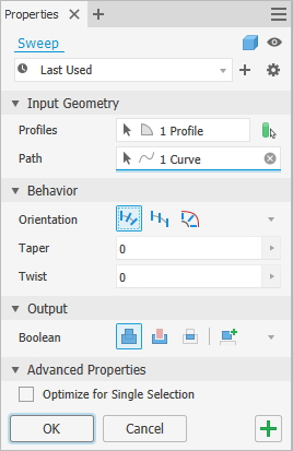

Sketch a profile and path on intersecting planes. The path must pierce the profile plane. The start point must be located on the intersection of the planes for profile and path.
Click 3D Model tab
Create panel
Sweep
If there is only one profile in the sketch, it highlights automatically. Otherwise, select a sketch profile.
In the Sweep dialog box, click Profile and then select the profile to sweep.
With the Path selection tool, select a 2D sketch, 3D sketch, or edges of geometry.
If there are multiple solid bodies, click Solids and then select the participating bodies.
Specify the Output type:
Solid. Creates a solid feature from an open or closed profile. Open profile selection is not available for base features.Choose Type
Path.
For a path sweep oriented to a path, specify Taper and Twist angles.
A positive taper angle increases the section area as the sweep moves away from the start point.
A negative taper angle decreases the section area as the sweep moves away from the start point.
With nested profiles, the sign (positive or negative) of the taper angle is applied to the outer loop of nested profiles; inner loops have the opposite sign.
Specify an Operation:
New Solid. Creates a solid body. Each solid body is an independent collection of features separate from other bodies. A body can share features with other bodies. If desired, rename the body.Click Ok or Apply to continue to use the Sweep command.
