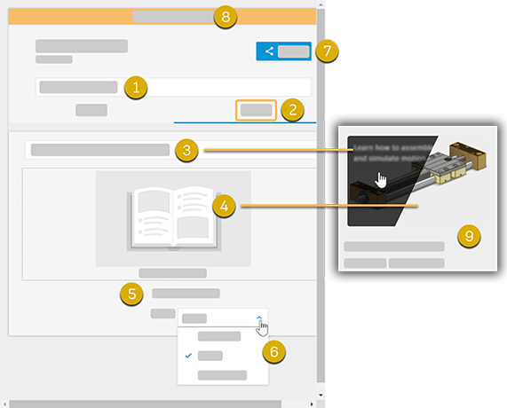

Guided Tutorial Interface
The tutorial interface has two main sections separated by tabs, Tasks and About.
- Tutorial Title - can be entered on either tab.
- About tab
- Tutorial description - enter a description that helps the audience know what they will learn from the tutorial. The description displays when the cursor is over the tutorial in the gallery.
- Thumbnail image - click to add the image to the tutorial.
- Author - the active user name. Not editable.
- Tutorial Type - choose from Quick Start, Basic, and Intermediate.
- Share - click to share the tutorial.
- Share status - status is both textual and color coded to make it easy to know whether or not the tutorial is shared.
- Tutorial gallery - the tutorial thumbnail, title, description, release and download count display in the gallery.
