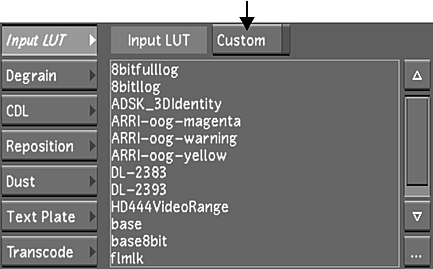

To apply an existing input LUT:
  1. Select a shot in the Storyboard to which you want to apply an input LUT.
  2. In the Input LUT menu, select either a 1D input LUT or a 3D input LUT from the Input LUT list and then enable Custom.
    The input LUT is applied to the current shot.
  3. To select a LUT originating from another station, expand Extra LUT from Grade in the Input LUT list, and then select the LUT.

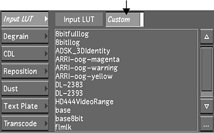

To turn off an applied input LUT:
  1. Select a shot in the Storyboard with an input LUT.
  2. In the Input LUT menu, disable Custom.
    The input LUT is no longer applied to the shot.
  3. Click the input LUT in the input LUT list to remove it completely.
    The input LUT is deselected.
