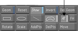

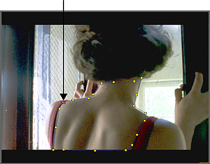

To draw a free-form geometry using AutoTangent mode:
  1. In the Secondaries menu, right-click a secondary layer button to activate it.
  2. Enable Show.
    Any pre-existing geometries will be displayed in the Player.
  3. Enable the Free-Form (Bezier) button.
    Note:To add more than one of the same free-form shape to a secondary, you must enable the Free-Form shape button each time.
  4. Enable AT (auto tangent).
  5. In the Player, click the image to set the first vertex.
  6. Click again to add the second vertex.
    As you move from one vertex to the next, the tangents are automatically interpolated to create a smooth curve between vertices.
  7. Continue clicking the image to add vertices and create the geometry.
  8. To close the free-form geometry, click the first vertex.
    Image courtesy of Hungarian Academy of Film & Theatre, 3rd year

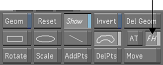

To draw a free-form geometry using Freehand mode:
  2. Enable Show.
  4. Enable FH (freehand).
  5. In the Player, click and drag on the image to draw the geometry.
    The vertices and tangents of the geometry are automatically added as you drag the mouse. The optimal number of vertices is used to create the smoothest curve.
  6. To close the free-form geometry, release the mouse.
