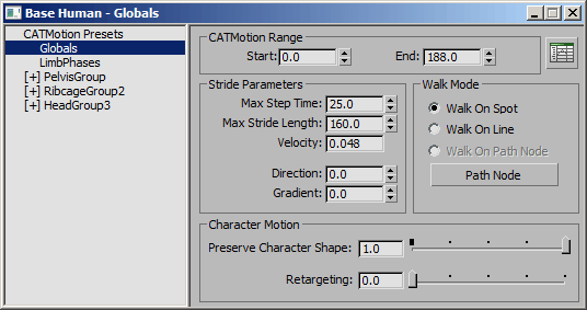

<CATHierarchyRoot>.PathFacingRatio : float
Get/set the Path facing ratio.
<CATHierarchyRoot>.CATMotionFlags : integer
Get/set the CATMotion flags value.
<CATHierarchyRoot>.Retargetting : float
Get/set the retargeting value.
<CATHierarchyRoot>.ActiveLeaf : integer
Get/set the active leaf index.
<CATHierarchyRoot>.StartTime : float
Get/set the CATMotion's Start Time value.
<CATHierarchyRoot>.EndTime float
Get/set the CATMotion's End Time value.
<CATHierarchyRoot>.MaxStepTime float
Get/set the max. step time value.
<CATHierarchyRoot>.MaxStepLength float
Get/set the Max Stride Length value.
<CATHierarchyRoot>.Direction float
Get/set the Direction value.
<CATHierarchyRoot>.Gradient float
Get/set the Gradient value.
<CATHierarchyRoot>.WalkMode: integer
Get/set the Walk Mode value.
Possible values are:
0 - Walk On Spot
1 - Walk On Line
2 - Walk On Path Node
<CATHierarchyRoot>.StepEase float
Get/set the Step Ease value.
<CATHierarchyRoot>.DistCovered float
Contains the covered distance value.
