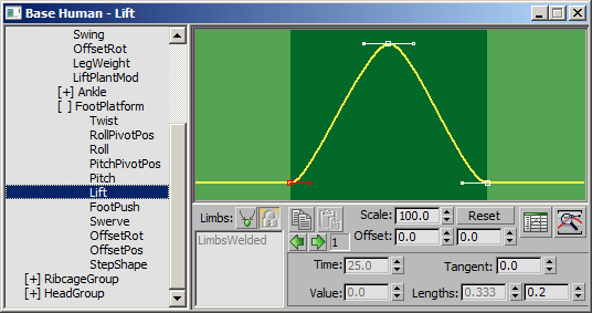

This is a CATMotion Controller used in the animation of feet in 3ds Max CAT.
Constructors:
Class instances not creatable by MAXScript
Aliases:
CATFootLift FootLift
Properties:
<CATFootLift>.CATBranch : maxObject
Contains the Branch controller.
<CATFootLift>. LimbData (CATLimbData) : maxObject
Contains the LimbData controller object.
<CATFootLift>.Amount : float
Get/set the foot lift amount.
<CATFootLift>.LiftTangent : float
Get/set the foot lift tangent value.
<CATFootLift>.LiftTanLength (LiftTanLen) : float
Get/set the foot lift tangent length value.
<CATFootLift>.PeakTangent : float
Get/set the peak tangent value.
<CATFootLift>.PeakInTanLength (PeakInTanLen) : float
Get/set the peak in tangent length value.
<CATFootLift>.PeakOutTanLength (PeakOutTanLen) : float
Get/set the peak out tangent length value.
<CATFootLift>.PeakTime : float
Get/set the peak time value.
<CATFootLift>.PlantTangent : float
Get/set the plant tangent value.
<CATFootLift>.PlantTanLength (PlantTanLen) : float
Get/set the plant tangent length value.
