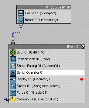

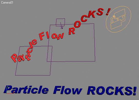

The following example uses a Script Operator to assign a single letter to each particle based on a scene text objects. You can type in any text you want, define the font and change the appearance of the text using modifiers like Extrude and Bevel and let Particle Flow generate a stream of letters showing the text.
Can Be Used With:
The scripts should be used inside a Script_Operator.
Effect:
Note:
The source object must be a text object with some meshing modifier on top. Do not collapse the stack to EMesh as the script needs access to the text baseobject's font and text properties!
