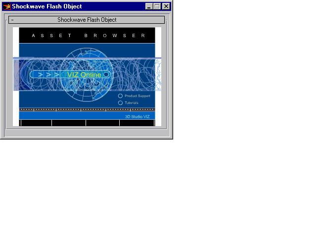

Here is a sample script that creates a text object and sets the text to FSCommand event argument value sent by Shockwave Flash objects:
EXAMPLE
rollout rFlash "Shockwave Flash Object"
local txtObj
fn checkTextObject =
if $text01 == undefined then
txtObj = text text:"" name:"text01"
addModifier txtObj (extrude amount:10)
txtObj.wirecolor = red
rotate txtObj 90 x_axis
else ( txtObj = $text01 )
activeXControl axFlash "{D27CDB6E-AE6D-11CF-96B8-444553540000}" height:200 width:300 align:#left
on axFlash OnReadyStateChange arg1 do format "handler: OnReadyStateChange : %\n" arg1
on axFlash OnProgress arg1 do format "handler: OnProgress : %\n" arg1
on axFlash FSCommand arg1 arg2 do
checkTextObject()
txtObj.text = arg1 + "+" + arg2
max tool zoomextents all
on rFlash open do
axFlash.movie = "e:\\Movie1.swf"
axFlash.movie = "e:\\Movie1.swf" -- need to load 2nd time sometimes
checkTextObject();
flashFloater = newRolloutFloater "Shockwave Flash Object" 350 300 10 10
addRollout rFlash flashFloater
