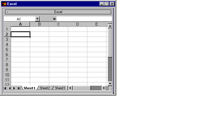

Creates a Microsoft Excel spreadsheet inside an embedded Microsoft Internet Explorer browser control. It also registers the rollout as an extended viewport -
SAMPLE SCRIPT
rollout rExcel "Excel"
activeXControl ax "e:\\test.xls" height:250 width:370 align:#center
fExcel = newRolloutFloater "Excel" 390 270
addRollout rExcel fExcel
format "----Application----"
showProperties rExcel.ax.application
format "----Parent----"
showProperties rExcel.ax.parent
format "----Container----"
showProperties rExcel.ax.container
-- In case of MS Excel .document points to the msexcel.workbook
workbook = rExcel.ax.document
format "----Document----"
showProperties workbook showHidden:true
showMethods workbook showHidden:false
props = getPropNames workbook
sort props
for prop in props do
try
format "\t%=%\n" (prop as string) (getProperty workbook prop)
) catch ()
