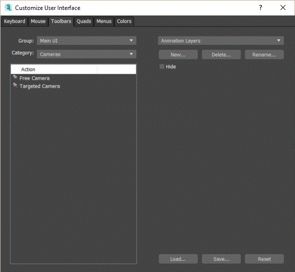

After MAXScript evaluates a macroScript construct, the MacroScript definition shows up in the appropriate category list in the Customize User-Interface dialog. The following figure shows a Customize User Interface dialog containing the previous two MacroScripts.
If a tooltip is specified, that tooltip is the name shown in the Customize User Interface dialog. If a tooltip is not specified, <name> is the name shown. Unlike other similar constructs (Scripted Utilities, Functions, and right-click menus), macroScript does not create a variable with this name. Rather, MacroScripts are stored as pointers into files, as described below.
You can use non-alpha numeric characters to define any of the argument strings. This includes support for escaped double quote characters: \".
The category: argument specifies in which category of the Customize User-Interface dialog the MacroScript name is listed. The use of categories is intended to help you organize your MacroScripts into groupings so that the MacroScript names are less likely to clash. If you do not specify a category, a default category of "unknown" is used.
The internalCategory argument is intended to identify operations in .cui, .mnu, and .kbd files.
The toolTip: argument specifies the tooltip for the button. If no tooltip is specified, <name> is displayed for the button.
The buttonText: argument specifies the text that appears in the button, and the icon: argument specifies the icon that appears in the button. You can choose in the Customize User Interface dialog whether the buttonText or icon appears in the button. If no buttonText: argument is specified, the MacroScript name is used as the buttonText .
