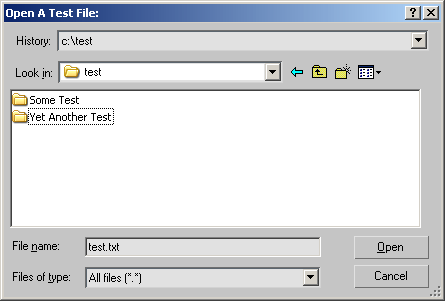

When the optional keyword filename: is supplied, the string is used to define the path and file name of the file to be loaded or saved. The dialog automatically navigates to the specified path (if available on the disk/network), displays its content in the browsing area and suggests the file name in the "File name" field. If the path does not exist, the current path is used and only the file name is displayed as requested.
FOR EXAMPLE
f = getOpenFileName caption:"Open A Test File:" \ filename:"c:/test/test.txt" --if the path exists, will result in something like:
