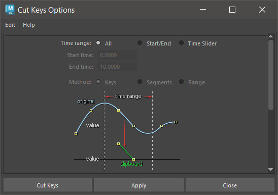

Determines the range of keys to be cut or copied. Select from the following options:
Cuts or copies all keys for the current object to the clipboard.
Cuts or copies all keys between the values you specify in the Start Time to End Time fields.
Specifies whether the keyset will include keys only or keys and animation curve segments (available if Start/End or Time Slider is on).
Specifies how the keyset is copied to the keys clipboard after it is removed.
Specifies removing keys within the specified range. If there are keys remaining adjacent to both ends of the deleted area, the animation curve(s) produced will retain the out tangent and in tangent of the key in the cut area.
Specifies removing keys within the specified range. Any keys preceding the cut are moved to the start time of the cut area, effectively “shuffling forward” the animation curve to fill the resulting gap.
Adjusts the keys clipboard curves in value and adjusts the segment of the original curve following the pasted segment. This prevents discontinuity in the animation (available if Collapse is on).
