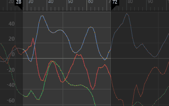

Specifies the start of the time range. This is available only if Start/End is on.
Specifies the end of the time range. This is available only if Start/End is on.

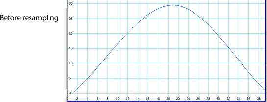

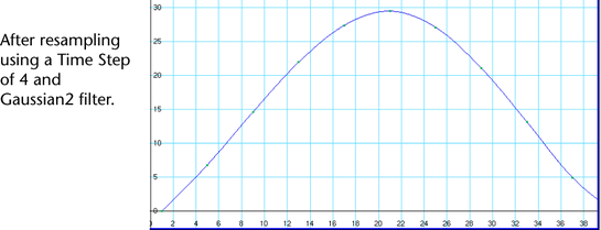

Specifies the resampling filter, which is an algorithm that defines how the keys in the curve are resampled. Choose one of the following:
Uses the value of the sample that is closest to the nearest time step.
Uses linear interpolation between two samples closest to the nearest time step.
Sums up all the samples in the filter area with an equal weight.
Uses a linear curve that affects the keys so that the least filtering happens at the edges of the sampled area.
Uses a sloped curve that weights the sampling gently at the top of the peak and toward the edge of the sampled area. This is the default.
Similar to the Gaussian2 filter but with a narrower base.
Sets the period for resampling. If you set Time Step to 4, then a key is placed every four frames. Resampling works best when the Time Step period is greater than the frequency of key frames on the curve.
