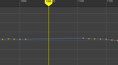

- Set key(s) at Boundary
- Sets a key at the deleted frame, or on the current frame if no key is set, to preserve animation so the integrity of the curves are maintained. See the following animation.
Remove Before Current Frame:
Set key(s) at boundary active, followed by SSet key(s) at boundary option disabled.
