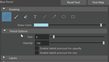

Use these settings to work with the Blue Pencil tool.
in the Last Used tool area of the
Tool Box, or
The Tool settings icon (circled)
Blue Pencil Tool settings: the options for each tool display beneath once you select the tool
For information on how to use Blue Pencil drawing tools, see Draw in the Viewport with Blue Pencil.
Lets you draw freehand at the current time in the Time Slider.

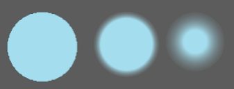

Lets you draw freehand with a configurable edge hardness at the current time in the Time Slider.
Brush strokes of same size and opacity with Hardness set to 100, 70, and 6
Erases Blue Pencil strokes on the sketch at the current frame.
Drag across the screen to create a straight line. Set a thickness for the stroke with the Size setting, and an opacity level with the Opacity setting.
Drag across the screen to create a line capped with an arrowhead. Set a thickness for the stroke with the Size setting, and a transparency level with the Opacity setting.
Drag across the screen to create an oval shape. Set a thickness for the stroke with the Size setting, and an opacity level with the Opacity setting.
Drag across the screen to create a square shape. Set a thickness for the stroke with the Size setting, and an opacity level with the Opacity setting.
