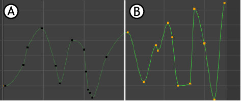

Animation curve in the Graph Editor: A. Referenced locked, B. Referenced, unlocked
