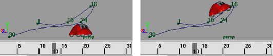

You can change the shape of an existing path curve by changing the current time, moving the object to a new position, and selecting . An example of animation before and after this menu item follows:
