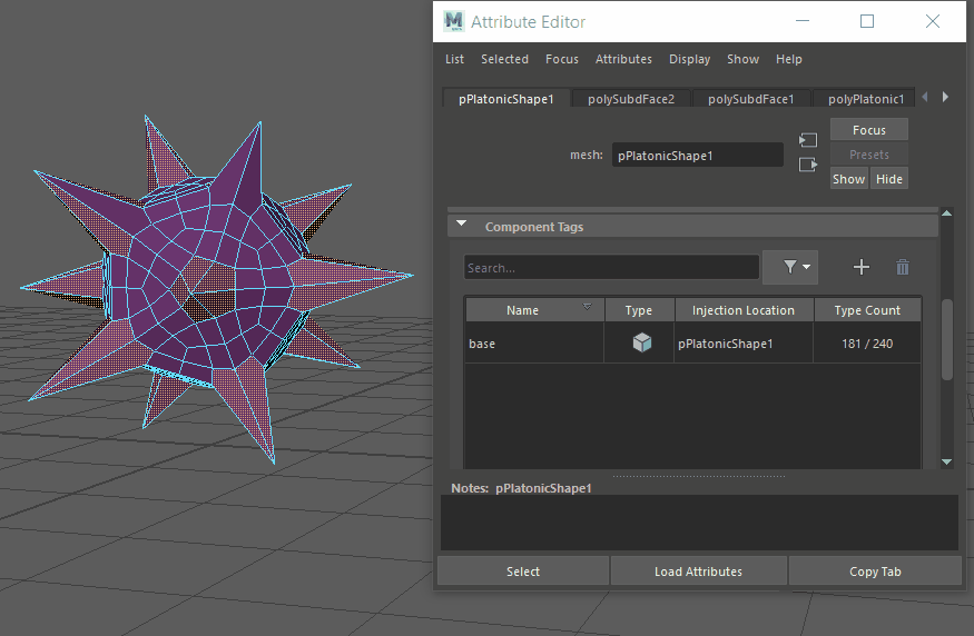

- Add Component Tags
- Select the geometry on a polygon on which you want to add a
Component Tag: faces, vertices, or edges. (To select components on geometry, press
F8 to enter Component mode, and Shift or Ctrl-select components.)
- In the
Attribute Editor, click the shape node tab of the geometry and expand the
Component Tags section. (The settings in this section are described in
Component Tags table.)
- Click the
Add icon
on the right side of the table to create an
unnamedTag entry.
- Right-click the new unnamedTag and select
Components >Replace to fill the tag with your selected components.
Note: You cannot combine different component types, for example faces
and edges, in the same
Component Tag selection.

The default
Component Tags of polyCube1.
- Add/remove elements from a
Component Tag membership
- In the
Component Tags section in the
Attribute Editor, right-click the
Component Tag entry in the table and choose the following functions:
