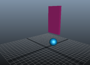

This example illustrates how to use Set Driven Key to link the attributes of a door object to the attributes of a ball, so that the movement of the ball drives the movement of the door.
You can easily set up a similar scene to try the example yourself:
(Scale and position it roughly so that it lies along the X-axis.)
(Scale and position it just in front of the door, roughly at 0, 1, 10.

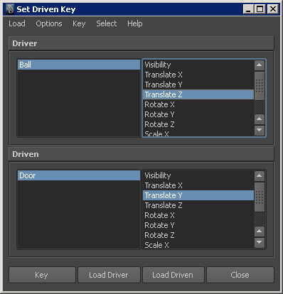

To link the door’s movement to the ball’s movement
The Set Driven Key window appears with the door in the Driven list.
The ball appears in the Driver list.
This sets a driven key relationship that links the current Translate Z value of the ball to the current Translate Y value of the door. Whenever the ball’s Translate Z is at this position, the door’s Translate Y will be at its current position.
This sets another driven key that links the current Translate Z value of the ball to the Translate Y value of the door.

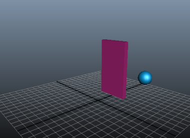

You’ve set three driven keys that link the attribute values at different positions. If you drag the ball toward the door from either side, the door rises smoothly. You can also flip through your driven keys by selecting Key > Go To Next or Key > Go To Previous in the Set Driven Key window.
Notice that playing back the animation from the Time Slider doesn’t move the ball or the door. This is because driven keys link one attribute to another, they do not link attributes to times in the Time Slider. However, if you go on to set keyframes and animate the position of the ball, the door will still move automatically, based on the driven key relationship.
