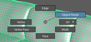

Shift + S +click in the Graph Editor Graph View to display a marking menu of options for keys (swipe left) and Tangents (swipe right). See Keyframe Tangent Marking menu for a description of the options.
Right-clicking a polygon or NURBS object in the scene brings up a marking menu of many commonly used commands.
| Menu Item | Effect |
| Components | The upper radial section of each object type displays options to change the current component selection mode for that object.
Note: Objects remain selected even when switching between various object and component modes.
