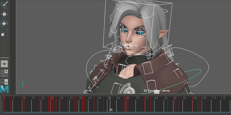

Subframe keys in the Dope Sheet have a star in the corner
Use the
Time Snap
option in the
Dope Sheet toolbar to make frames snap to whole values.
