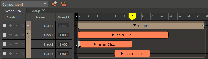

To create a Local Time tab from a Group clip:
A Group tab appears along the top of the Time View.
You can tell you are viewing the clip in local "clip" time because the clip starts at Frame 1 and its duration is its original timing, as opposed to anything that has been done to the Group clip that contained it.
