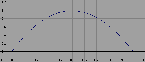

Select the weight curve’s keys or tangents, select the Move Tool from the Maya toolbox, and middle-drag the keys or their tangents to change the shape of the curve. For example, you can reshape the default blend weight curve to make it resemble the following:
With this curve, the first clip in the blend starts with 100% control at the start of the blend, decreases to 0% at the middle, then increases to 100% control at the end of the blend. The bottom clip changes correspondingly from 0% to 100% to 0% control during the blend.
Select the Insert Keys Tool or Add Keys Tool from the Graph Editor Keys menu, and middle-click the curve to add additional keys to the curve. You can then use these new keys to alter the shape of the weight curve.
