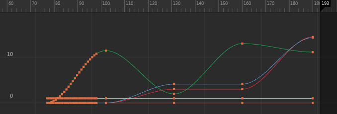

In the
Graph Editor, click
, or select
Edit > Transformation Tools > Retime Tool to enable the
Retime Tool.
The Retime Tool lets you directly adjust the timing of key movements in an animation sequence. See Retime animation.
