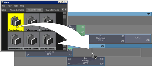

To copy a source clip in the Visor and paste it to a character in the Trax Editor
A white box representing the clip you are inserting appears under your mouse pointer in the track view area. This white box is the same length as the source clip that you are copying.
Also, if your mouse pointer is between tracks, a black line appears indicating that a new track will be created between the tracks to house the clip you are copying. For more information on adding a track to a character, group, or subcharacter, see Select, add, and remove tracks.
When you release the mouse button, an instance of the source clip appears at the location (track and point in Trax timeline) of the white box.
An instance of the selected source clip appears under the character in the track.
