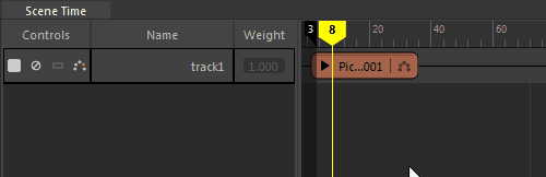

| Show keys | Click
in the
Roster controls (or press
V on a parent group or single clip to show animation keys for the track.
![]() The keys appear as a vertical bars. See Keying animation in the Time Editor. |

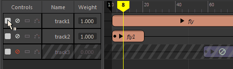

| Change track playback (mute, solo, and so on) in the Time Editor |
