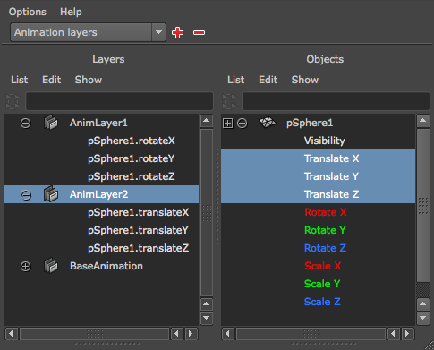

To add or remove attributes using the Relationship Editor
The Relationship Editor opens, displaying all of your animation layers in the left side panel, and the selected object(s) in the right side panel.
You can also expand the layer to confirm which attributes are assigned to it.
Any attributes that are already assigned to the selected layer are highlighted.
The attribute is added to the layer, and its name is added beneath the layer name in the left side panel. In the right side panel, the attribute is highlighted to indicate it is a member of the selected layer.
The attribute is removed from the layer, so it no longer displays in the left side panel and is no longer highlighted in the right side panel.
