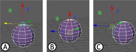

Relative space modes using UVpin and a Locator: A. World B. Local C. Custom
| Space | Function |
| World |
(Default) Uses the center of the scene as the origin. |
| Local |
Uses the geometry space for evaluation. |
| Custom |
Use an external matrix as the space for evaluation. |

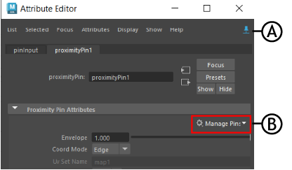

The Attribute Editor Proximity Pin tab contains extra settings that are not covered in the Connections and Coordinate System sections.
Attribute Editor: A. Pin Tab, B. Manage Pins menu
| Select Geometry | Selects the geometry affected by the UV pin. |
| Replace Geometry with Selected | Switches the pinned geometry with another selected geometry. |
| Create Pins | Creates a new PinOutput node. Select a node (locator/geometry/group, and so on) and the Pin node outputs a pin value, connecting it to the node (depending on the Pin default setting). |
| Edit Pin Defaults | Opens the UV Pin window, where you can set new values for the default pins: Existing Transform, New Transform, New Locator, or Matrix. |
while using this menu to keep the current attribute tab displayed when the selection changes.
