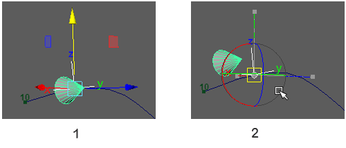

To offset an object
The transformation axes appear on the object, as shown in figure 1.
A center dot appears at the object's pivot point.
The object moves in the opposite direction to the mouse movement, but the pivot point remains in place, as shown in figure 2.
