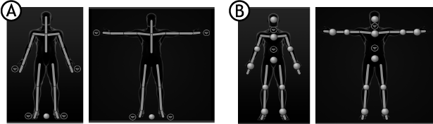

Character controls templates A. CharacterControlsConfig and CharacterControlsConfig_T B. CustomRigControlsConfig and CustomRigControlsConfig_T
The CharacterControlsConfig_T and CustomRigControlsConfig_T files found in the resources > Character Controls folder are versions of the templates in the CharacterControls file but the representation is a T-Stance or base pose instead, which is sometimes preferred by animators.
Sometimes the T-pose version of the character representation is offset or misaligned in the window. If this occurs, resize the HIK Panel wider and click Create Skeleton.
