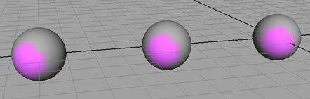

When working with instances of an object, you can assign Color Per Vertex (CPV) data to instances separately from their source. This allows you to create shared CPV data across all instances based on an existing instance, assign different CPV data to all instances.
To create shared Color Per Vertex data per instance
The Color Set Editor appears. See Color Set Editor Options.
The Create Empty Color Set Options window appears. See Create Empty Color Set Options.
The painted colors appear on all instances of the object (including the source).

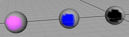

To create unshared Color Per Vertex data per instance
Each instance you create a new unshared color set for, is colored differently. If you rename one of these unshared color sets, the corresponding unshared color sets on other instances are renamed accordingly.
