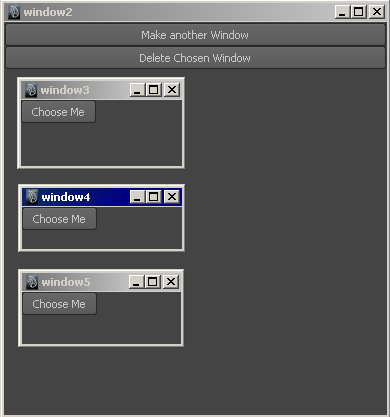

In this example, MEL makes a window that can be used to create more child windows. The $chosenOne global variable tracks which child window the user has selected. Within each newly created child window, there is a chooseMe button that the you can click to set that specific window as the $chosenOne. When you click Delete Chosen Window in the main, parent window, the $chosenOne gets deleted.
In the image below, window4 is the $chosenOne, and will be deleted when Delete Chosen Window is clicked.
The code is as follows:
global proc int pressMe(string $thisOne) { global string $chosenOne; print ("was " + $chosenOne + "\n"); $chosenOne = $thisOne; print ("nowIs " + $chosenOne + "\n"); return 1; } ; global proc int satWindow(){ string $temp = `window -width 150`; columnLayout -adjustableColumn 1; button -label "Choose Me" -command ("pressMe " + $temp); showWindow; return 1; } global proc int baseWindow() { global string $chosenOne; window -width 150; columnLayout -adjustableColumn true; button -label "Make another Window" -command "satWindow"; button -label "Delete Chosen Window" -command "deleteUI -window $chosenOne"; showWindow; return 1; } baseWindow()
