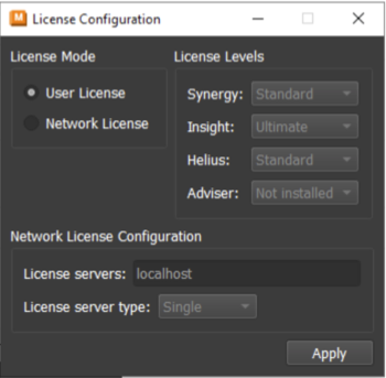

The first step after installing your products, is to configure the software license using the License Configuration tool.
The License Configuration tool can be accessed from the Windows Start menu, located in the Autodesk Moldflow Adviser folder.
| Named User License configuration |
Once you activate the License Configuration tool, select the License Mode you wish to apply.
With the Named User license the default license is:
Click Apply to accept your Named User License setup and close the License Configuration tool.
