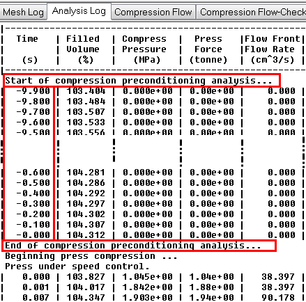

Analysis Log (reactive compression molding only)
In the log file, the preconditioning stage of the analysis is shown in negative numbers from - (delay time) to 0.
Figure 1: Section of the Analysis Log, showing the preconditioning analysis results
