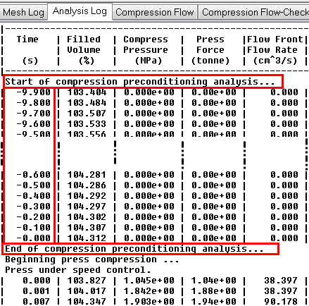

In the log file, the preconditioning stage of the analysis is shown in negative numbers from - (delay time) to 0.
Figure 1: Section of the Analysis Log, showing the preconditioning analysis results
To understand the temperature and the degree of cure at the end of preconditioning, look at the first step of the Temperature result and of the Conversion at node result. The results that correspond to the end of preconditioning are at, or close to time=0.
