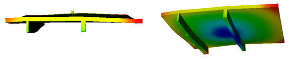

Figures 1 and 2 below show how warpage simulations can vary depending on the type of constraints that were set on the part.
Typical deformation of a part with automatic constraints (scale factor=10.00)
However, setting specific constraints on a part enables early prediction of any unwanted behavior of a part in real conditions of use.
Simulation of the constraints that will be applied on the part when in use, and deflection resulting from these constraints. (scale factor=10.00)
