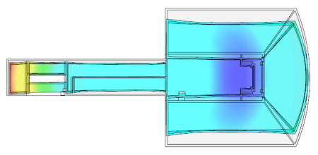

The image in the Model pane shows an outline of the original part with the colored model reflecting the final warped part. The extent and shape of the warpage is not obvious in this graphic . You will magnify the extent of the warpage by a factor of 10 to help overcome this.
Click on the ViewCube and rotate the model until the Back is facing you.
Click
( Results tab > Properties panel > Plot Properties), and select the Deflection tab from the top of the dialog.
In the Scale Factor box, set the Value to 10 and select only the Y direction. Move the Plot properties dialog box so that the large portion of the model is visible. Click Apply. The warpage in the Y direction is now apparent.
Image 1: Deflection, all effects:Deflection - Y axis, scale factor 10
Select Z as the only Direction for the Scale factor , clear the Overlay with undeformed part check box, and click OK. Rotate the model.
The deflection in the Z-direction is now shown.
Image 2: Deflection, all effects:Deflection - Z axis, scale factor 10
