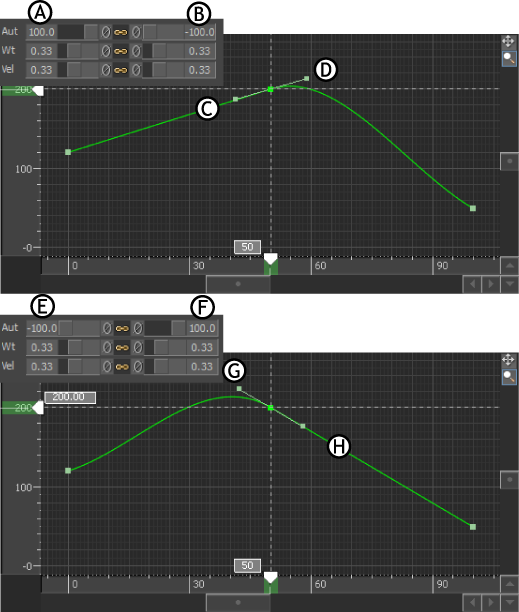

The Auto settings include two fields and sliders (A and B) which let you change the value of the left and right tangents of editable keyframes. The field on the left side affects the left tangent, and the field on the right side affects the right tangent.
Editing tangent angles using Auto settings A. Left Auto field set to 100 B. Right Auto field is set to -100 C. Left tangent pointing to the previous keyframe D. Right tangent pointing away from the previous keyframe E. Left Auto field set to -100 F. Right Auto field set to 100 G. Left tangent pointing away from the next keyframe H. Right tangent pointing to the next keyframe

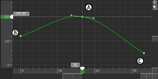

When you use the Auto settings, the tangents of editable keyframes are automatically calculated based on the values of neighboring keyframes.
Keyframe with Auto interpolation A. Tangents are the average between the previous and next keyframes B. Previous keyframe C. Next keyframe
The values in the left and right Auto fields change the angle of tangents as described in the following table.
| 0 | At 0, the curve represents the average between the previous and next keyframes. |
| 100 | When the left Auto field is at 100, the left tangent points to the previous keyframe (A and C). When the right Auto field is at 100, the right tangent points to the next keyframe (F and H). |
| -100 | When the left Auto field is at -100, the left tangent points away from the next keyframe (E and G).When the right Auto field is at -100, the right tangent points away from the previous keyframe (B and D). |

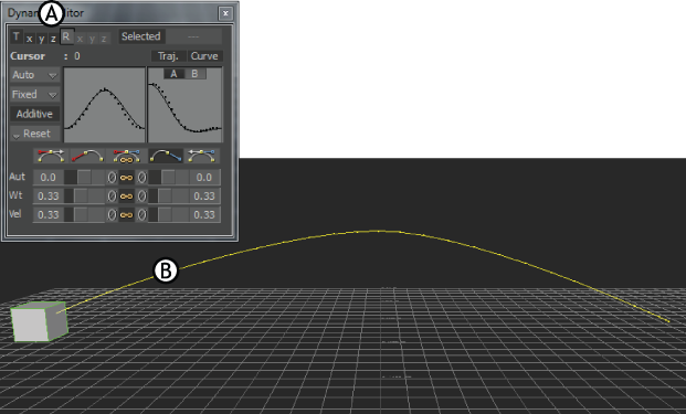

For example, in the following figure, keyframes are set for the X, Y, and Z values of a cube’s Translation property. However, the cube moves only along the X-axis and Y-axis during the animation, and the Z value remains the same throughout. The cube’s trajectory before any changes are made is an arc.
Animation before velocity changes A. XYZ Translation property values are shown selected B. Cube trajectory along the X-axis and Y-axis, in an arced path

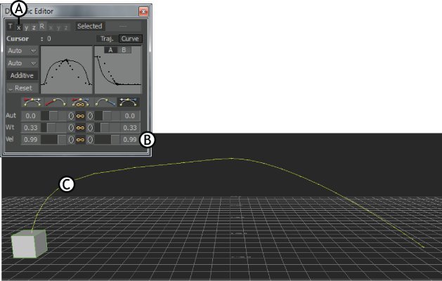

In the following figure, using Velocity does not work, because only the X value is selected and modified. The cube’s trajectory is changed as a result.
Bad example using Velocity settings to change the animation speed A. X Translation property value selected B. Velocity settings changed C. Result: The cube’s trajectory changes instead of the cube’s animation speed
This is an undesired result, which also occurs if, for example, only the Y value is selected, or if the X value or Y value is selected as well as the Z value. Selecting only the Z value has no effect at all, because the value does not change during the animation.

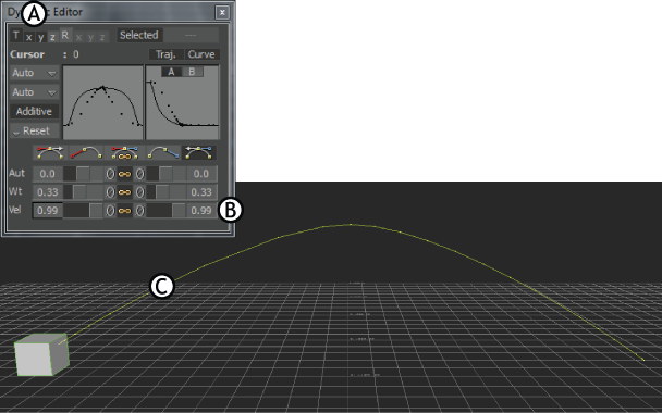

For the Velocity settings to work in this situation, both the X value and the Y value must be selected. When the Velocity settings are changed, the cube’s trajectory remains the same and the cube speeds up and slows down during the animation.
The Velocity settings would also work in this situation if all three XYZ values were selected. In some situations, selecting all XYZ values for selected keyframed properties can be simpler when using the Velocity settings.
Good example using Velocity settings to change the animation speed A. X and Y Translation property values selected B. Velocity settings changed C. Result: The cube speeds up and slows down during the animation
