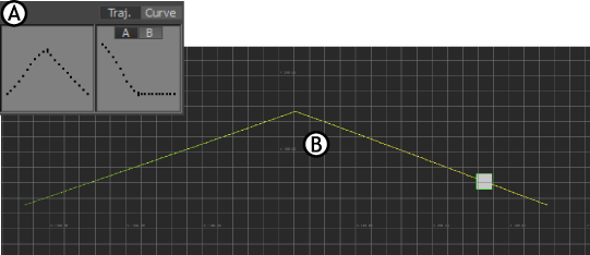

The Trajectory option lets you show or hide the trajectories, which display as dotted lines in the animation representation.
Animation displayed as a trajectory
A trajectory is a path of animation through space. For example, in the previous figure, the cube’s trajectory in the Viewer window is similar to the trajectory representation in the Dynamic Editor.
The dots represent motion through time, and display close together or far apart depending on the velocity of the animation.
Animation A. Trajectory representation B. Actual trajectory
The Trajectory option can be active at the same time as the Curve option, so you superimpose curve and trajectory representations.
Trajectories (dotted lines) and curves (solid lines) displaying animation

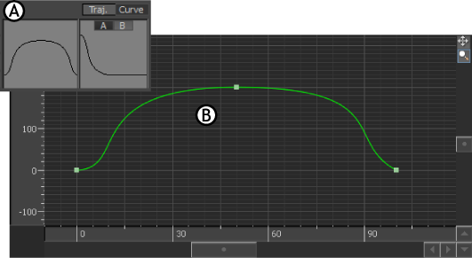

The Curve option lets you show or hide the animation curves, which display as solid lines in the animation representation.
Animation displayed as curves
A curve represents animation through time, similar to what you would see in the FCurves window.
Animation A. Curve representation B. Actual function curve of the animation
The trajectory of the animation as seen in the Viewer window can be different than its curve.
Animation A. Curve and trajectory representation B. Actual trajectory in the Viewer window
The Curve option can be active at the same time as the Trajectory option, so you can superimpose trajectory and curve representations. See Trajectory (Traj.) option for more information.

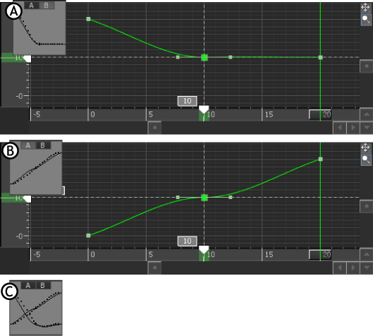

The A and B options let you show or hide different representations of trajectories and curves.
The A option lets you show or hide the representation of a function curve that descends and then plateaus.
The B option lets you show or hide the representation of a function curve with an incremental slope that can have a pause in the middle. Both options can be active at the same time to display both representations.
Animation representation A. The A representation. B. The B representation C. A and B representations superimposed
