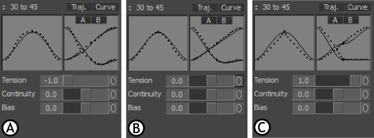

Tension
The Tension settings let you change the tautness of the function curve. For example, when Tension is set to a value of 1, the result is similar to a selected keyframe with Auto interpolation with flat tangents.
Changing tension A. Tension at -1 B. Tension at 0 C. Tension at 1

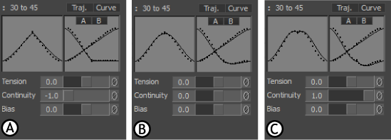

Continuity
The Continuity settings let you create a break in the curve to change that trajectory and speed of the animation.
When Continuity is set to a value of -1, the result is similar to using both the Discontinuity Right and Discontinuity Left buttons for a selected keyframe with Auto interpolation.
Changing continuity A. Continuity at -1 B. Continuity at 0 C. Continuity at 1

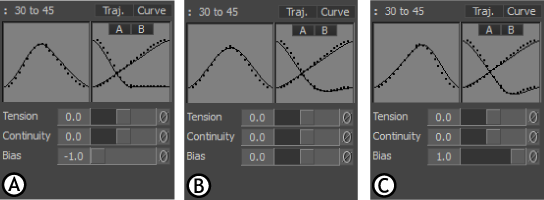

Bias
The Bias settings let you change the angle of the trajectories and curves in the animation, making them lean left or right. For example, when Bias is set to a value of -1, the result is similar to using the Discontinuity Right button on a selected keyframe with Auto interpolation.
Changing bias A. Bias at -1 B. Bias at 0 C. Bias at 1
