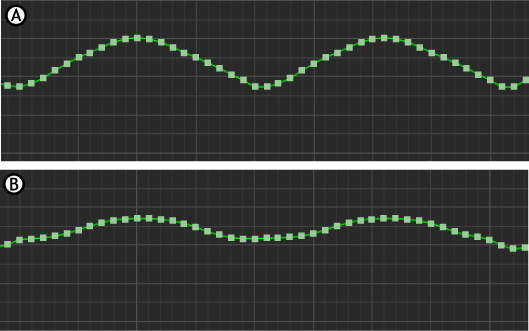

Smooth A. Original curve B. Smooth applied with Use Quaternions
