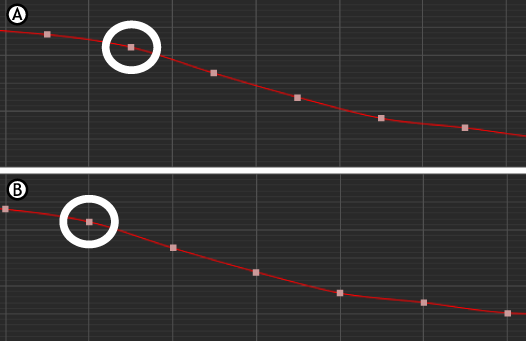

Keys on frame A. Original curve B. Keys on Frame applied
