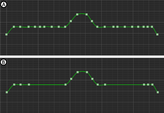

Reduces the number of keyframes by eliminating redundant keyframes.
For example, a function curve before applying the Constant Key Reducer filter has many keyframes. After applying the Constant Key Reducer filter, the number of redundant keyframes used by the function curve is reduced.
Key Synchronizing A. Original curve B. Constant Key Reducer filter applied
